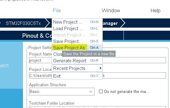

Hi. That option is disabled and can't be changed.
Yes, it will be disabled after the first generation.
The option can be available again, if you save the project using File > save as :
Then Application Structure can be changed.
