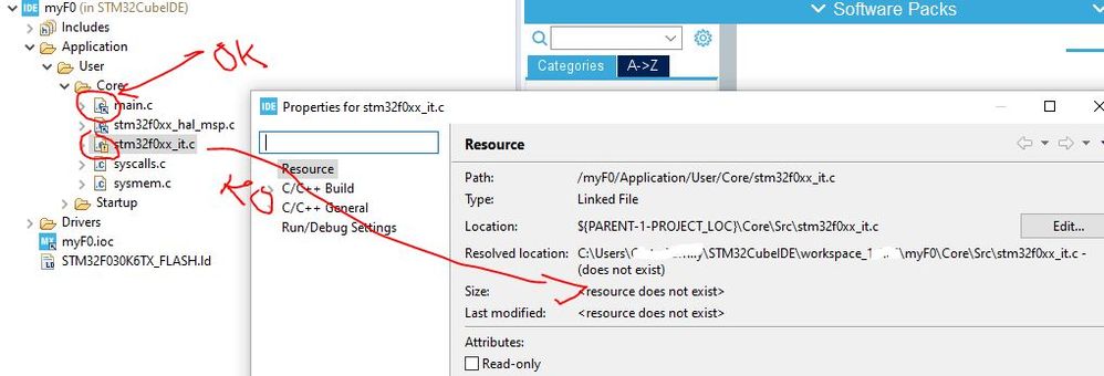

stm32cubeIDE deleting SRC folder, im posting this after it deleted my 2nd project
i always update stm32cubeIDE , cube mx on day 1 itself,
it is not deleting while i developing , only completed project getting deleted, i only noticing it when i open project folder for later use, only inc, startup folder available ... tried many recovery software to recover no luck,
(note: i duplicate older project to develop new one like template, i started from STM32CubeIDE 1.2.0 now currently using STM32CubeIDE 1.4.1)
please add auto backup core folder feature in later release

Startup folder available …. are linker scripts and .projet & .cproject available too or not ?
If yes maybe have you move your project location at a point ? Depending the way you're getting project alive some if source files are relying on linked resouces. If updating project env. without updating links may sounds like data lost.
Have a look to your resources small overlay icons ...

everything available except SRC folder,
i completed the project ,removed it from project explorer, i only noticing when l lookup the folder later to copy some code from it after some week
Final commit (before removing from project explorer) in git repository has SRC folder
problem i think is
i use same code base for different project because of same hardware board (copy it to different location and again import it and rename // or copy it inside project explorer and rename), so there is some trace of previous project location

This problem may be happen when you copy/paste a project folder!
When you work with pasted project, the Src folder of copied project is removed.
STM32CubeIDE Version: 1.4.2
