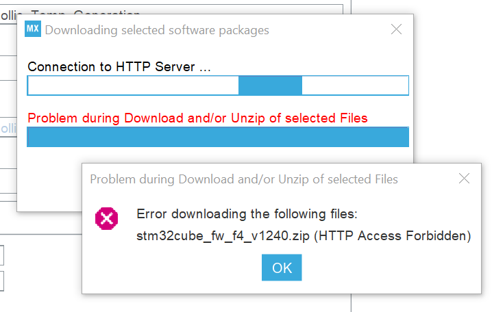

@Nawres GHARBI​ - Running the stand-alone CubeMX (as plug-in is missing).
Try to generate code, says need to update repository, then fails to download (this bug reported before).
Unable to generate code now...
Help!
Thanks,
Best Regards, Dave
