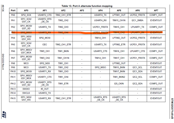

There is a blatant bug in the STM32CubeIDE that has costed me a board iteration on a professional product.

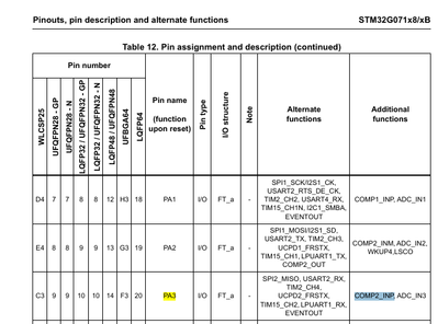

It says that pin PA3 is positive comparator input. When it isn't. Look here
This is what the datasheet says.
avburmel
Hello.
Comparator is an additional function. Not alternate.
