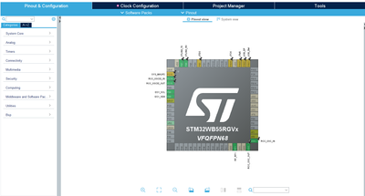

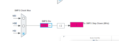

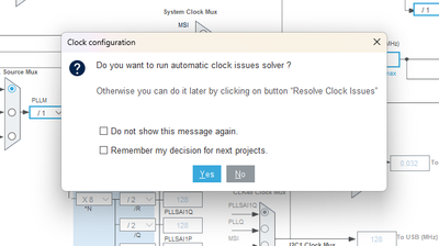

Hi, I'm facing a problem with the Clock Configuration tab with the latest version of the STM32CubeIDE. In fact, every time I open the ioc file, there is an error with the SMPS Clock Mux on the STM32WB board I'm using. I correct and generate code and saved but when I open the file again the error is still there. I'm using the latest version of the Cube.

I share some pictures of the problem. To correct the problem, I change the SMPS Clock Mux to HSE as shown in the tutorial. However, when I generate the code and save it goes to HSI again. I attach also the ioc.

I reproduced the behavior.
I will escalate the issue internally and get back to you as soon as I have an answer/feedback.
Internal ticket 190817 for follow-up.
Thank you for your patience.

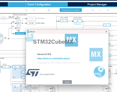

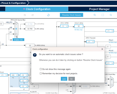

I have the same issue with CubeMX V6.15.0
Is there some way how to fix it? Thanks.

Please retry with the latest version of CubeMx: 6.16.0. Otherwise please open a new thread in STM32CubeMx forum board and attach your ioc file where you describe in details your config and the issue.
Thank you.
