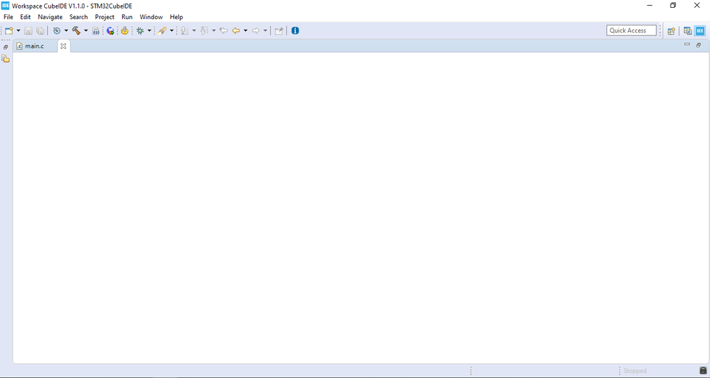

Hi.
After an Update from V1.0.2 the V1.1.0 works fine, but when I restart the program, it never open. I try to restart the computer, re-install de SW (downloading directly from the web), if I re-install a previous version (the V1.0.2) the program open.
Also I saw the task administrator, in details (in V1.1.0) the task STM32cubeide.exe (with 871492k of memory) apears but not the process.
A little problem on V1.1.0 in CubeMx the configuration window doesn't fit correctly, and the scroll bar don't appear.
My computer is a Lenovo Ideapad320 with an AMD A12 9720p and Windows 10 Home 64bit
thanks

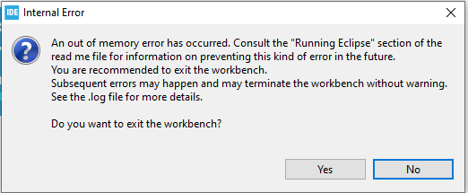

when I create a new project in V1.0.2 says "Java heap space" and close the IDE
2 replies

Juan Felipe IngeByte
December 3, 2019
I already uninstall and reinstall Java. Cube IDE V1.1.0 finally open correctly, but in the same way as in V1.0.2 doesn't charge CubeMx and if I try open repeatedly an internal error occurs.
to clarify, the CubeMx inside the CubeIDE
December 3, 2019
Update.
I Install the CubeMx Software, and I realized that I had the 32-bit version of Java by an error message. so I installed de 64 bit Version, and works ok. I assumed that it would also be solved in the CubeIDE, but nothing. just doesn't open correctly.
At the moment, I can work with the external CubeMx. but I leave the restlessness to the community and STM. I will be attentive.
