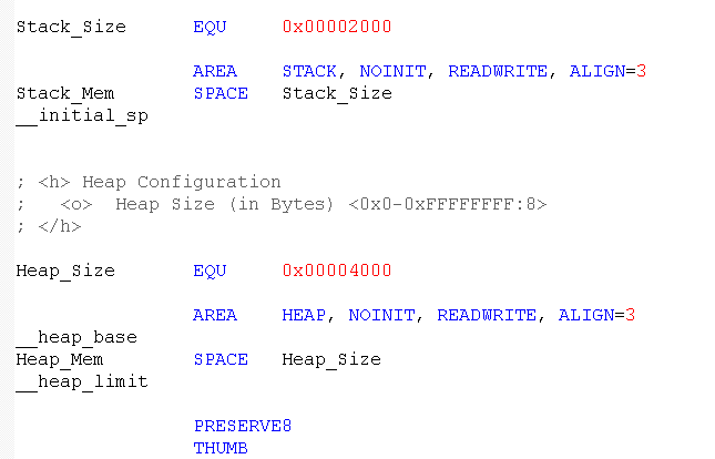

stm32cube-t
Posted on March 26, 2014 at 15:59
Hello Matteo,
If the answer below is not sufficient, please send us your STM32CubeMX project file (.ioc extension).
To enumerate in CDC class, the STM32F4 device requires minimum heap and stack sizes. Please modify the stack and heap sizes in the stm32f4xxx_startup.s file as shown in red in the snapshot below:
Be warned that those settings will be overwritten upon next code generation. This issue should be fixed in a future release.

stm32cube-t
Posted on March 27, 2014 at 10:54
Hello Matteo,
All 3 points mentionned above are correct:
- stack/heap size (note: if using IAR toolchain you should specify them in the .icf file, if using Keil, in startup.s).
- Flash latency: this is an issue being looked into.
- ''Dedicated endpoint 1 interrupt'' must be disabled: the underlying STM32CubeF4 firmware current version does not support enabling this interrupt. Next STM32CubeMX version will be fixed to show accordingly, i.e. that it can not be enabled.
