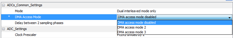

All right. It works. Question 2. Why DMA Continuous Requests only available when Independent mode?
talbi.amel
Posted on April 03, 2014 at 09:42
If you switch to a multiple mode (dual or triple), and if it is possible to use the DMA transfer, you have to use the ''DMA Access Mode'' parameter that will be available in the common settings section.
Best regards,
Amel.

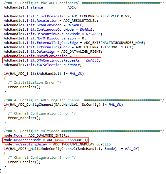

levak
Posted on April 03, 2014 at 10:13
STM32Cube_FW_F4_V1.1.0\Projects\STM324x9I_EVAL\Examples\ADC\ADC_DualModeInterleaved\Src\main.c
If AdcHandle1.Init.DMAContinuousRequests = ENABLE; is removed, the DMA interrupt is not activated.
STM32CubeMx does not add this line.
talbi.amel
Posted on April 03, 2014 at 16:54
The DMA is activated by the setting of the DMA bit in the CCR register.
but the DMAContinuousMode parameter is used to set the DDS bit that is used to be able to transfer data  continuously (Reference Manual: Requests can continue to be generated if the DDS bit is set to 1. This allows
configuring the DMA in double-buffer circular mode).
For the tool, you are right, this parameter should be also available for ADC multiple mode.
This will be fixed in the next release.

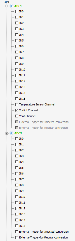

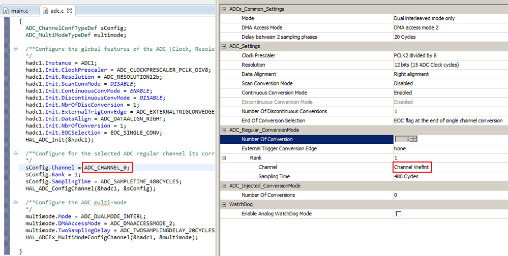

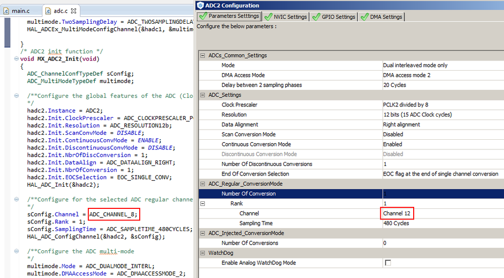

levak
Posted on April 08, 2014 at 12:55
In version 4.1.0 you broke change ADC channels, changes are not saved. (saved, but they differ sorce code.)
