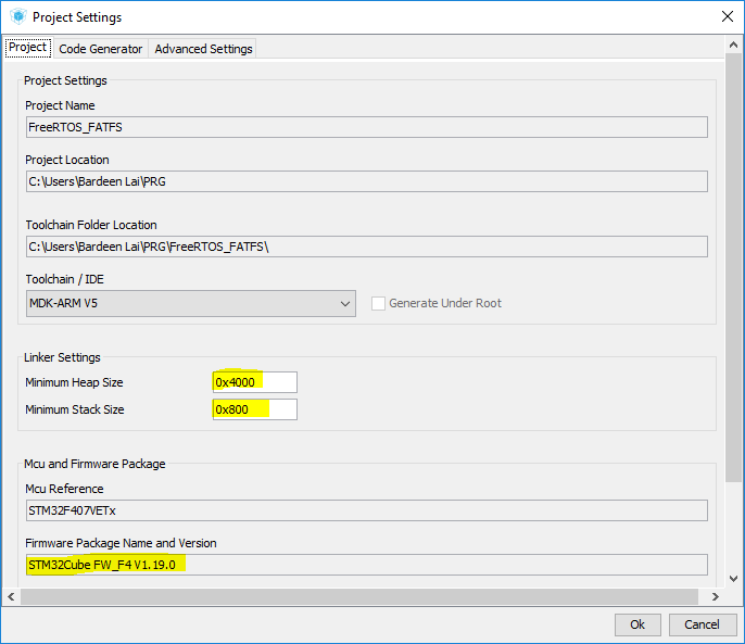

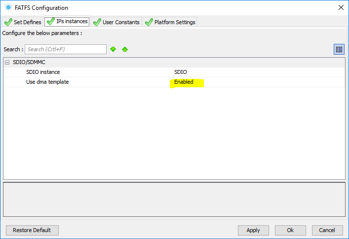

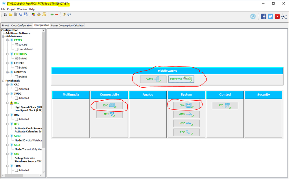

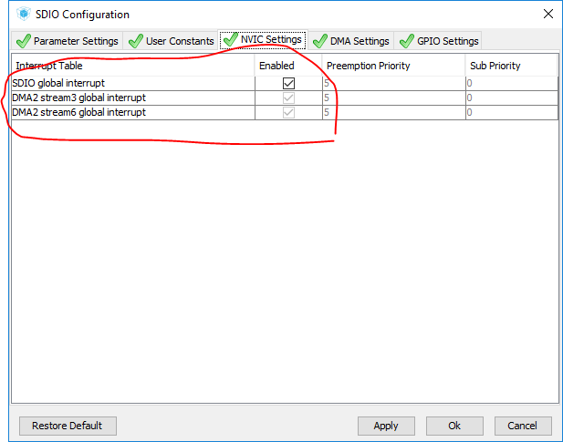

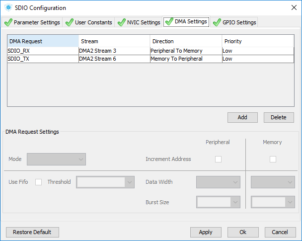

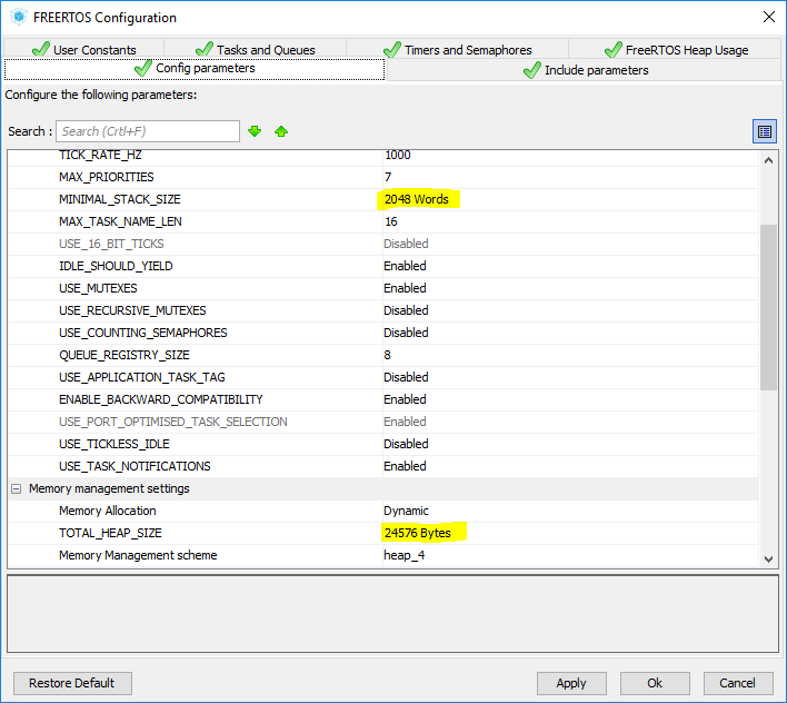

Posted on February 22, 2018 at 07:16
I have tested FATFS by use of DMA under FreeRTOS, it works!
Here is the screen capture of setting STM32CubeMX V4.24
Project Setting:
Make sure FATFS configuration ''Use dma template'' enabled:
SDIO settings:
Enable NVIC
and DMA settings
Then, tune the FreeRTOS, stack and heap sizes
After generating codes, you have to modify the following files:
A. sd_diskio.c (as told by
), you have to insert the following code at the end of the file
#endif /* _USE_IOCTL == 1 *//* USER CODE BEGIN afterIoctlSection *//* can be used to modify previous code / undefine following code / add new code *//* USER CODE END afterIoctlSection *//* USER CODE BEGIN callbackSection *//* can be used to modify / following code or add new code */void HAL_SD_TxCpltCallback(SD_HandleTypeDef *hsd){ osMessagePut(SDQueueID, WRITE_CPLT_MSG, osWaitForever);}void HAL_SD_RxCpltCallback(SD_HandleTypeDef *hsd){ osMessagePut(SDQueueID, READ_CPLT_MSG, osWaitForever);}/* USER CODE END callbackSection */�?�?�?�?�?�?�?�?�?�?�?�?�?�?�?�?�?�?�?
NOTE: HAL_SD_ReadBlocks_DMA and HAL_SD_WriteBlocks_DMA require DMA complete TX/RX interrupt to signal the foreground process whether the DMA TX/RX has been done or not.
B. If you are using MDK-ARM as your IDE, you should eliminate the ''U'', otherwise it would cause compiler error in port.c
Modify the stm32f407xx.h header file to fix error:
#define __NVIC_PRIO_BITS 4 /*!< STM32F4XX uses 4 Bits for the Priority Levels */�?
C. Modify the freertos.c file, insert the FATFS file test procedure:
/* USER CODE BEGIN FunctionPrototypes */void SDFileTest(void){ FIL MyFile; FRESULT res; /* FatFs function common result code */ uint32_t byteswritten, bytesread; /* File write/read counts */ uint8_t wtext[] = ''Hello, STM32F4 FatFs!''; /* File write buffer */ uint8_t rtext[100]; /* File read buffer */// printf(''SD File create''); // Create file test if (f_open(&MyFile, ''STMTXT'', FA_CREATE_ALWAYS | FA_WRITE) != FR_OK) Error_Handler(); res = f_write(&MyFile, wtext, sizeof(wtext), (void *)&byteswritten); if ((byteswritten == 0) || (res != FR_OK)) Error_Handler(); f_close(&MyFile);// printf(''done!'');// printf(''SD File open''); // Read file test if (f_open(&MyFile, ''STMTXT'', FA_READ) != FR_OK) Error_Handler(); res = f_read(&MyFile, rtext, sizeof(rtext), (UINT*)&bytesread); if ((bytesread == 0) || (res != FR_OK)) Error_Handler(); f_close(&MyFile); if ((bytesread != byteswritten)) Error_Handler();// printf(''done!'');}�?�?�?�?�?�?�?�?�?�?�?�?�?�?�?�?�?�?�?�?�?�?�?�?�?�?�?�?�?�?�?�?�?�?�?�?�?�?�?
and insert the following piece of code to
/* StartDefaultTask function */void StartDefaultTask(void const * argument){ /* init code for FATFS */ MX_FATFS_Init(); /* USER CODE BEGIN StartDefaultTask */ if (f_mount(&SDFatFS, (TCHAR const*)SDPath, 0) != FR_OK) Error_Handler(); SDFileTest(); /* Infinite loop */ for(;;) { osDelay(1); } /* USER CODE END StartDefaultTask */}�?�?�?�?�?�?�?�?�?�?�?�?�?�?�?�?�?�?�?
I could email you the complete project file if you need.
Good luck and cheers
Bardeen LAI
