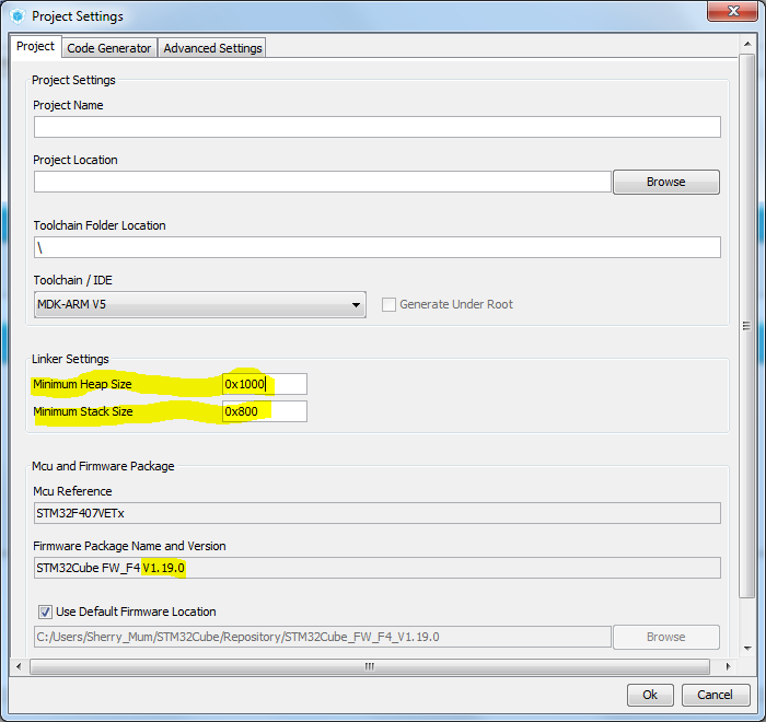

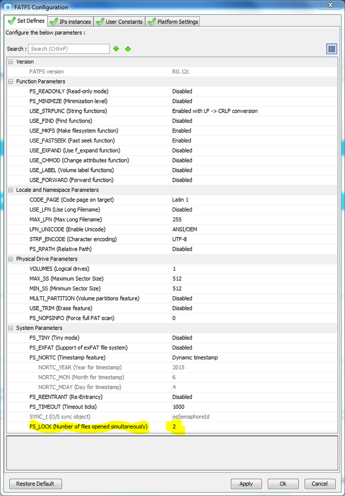

‎2018-02-18 8:27 PM
Hi, all
Again, the latest STM32CubeMX V4.24 with STM32F4 HAL firmware V1.19 is great and works well for FATFS R0.12C!
I guess some of you CANNOT mount or open files properly could be one of the following issues:
1. Make sure the project setting of heap and stack sizes are enough, for example
Heap size: 0x1000
Stack size: 0x800
2. Make sure the number of files opened simultaneously >=2, please change the number if you open or create files more than 2!
3. If you are going to use DMA, then you have to activate the DMA settings at SDIO
If you still have problems, please refer to some examples of STM32CubeMX located at ''C:\Users\xxx\STM32Cube\Repository\STM32Cube_FW_F4_V1.19.0\Projects''
Good luck and cheers
Bardeen LAI

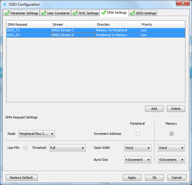

I have tested FATFS by use of DMA under FreeRTOS, it works!
Here is the screen capture of setting STM32CubeMX V4.24
Project Setting:
Make sure FATFS configuration ''Use dma template'' enabled:
SDIO settings:
Enable NVIC
and DMA settings
Then, tune the FreeRTOS, stack and heap sizes
