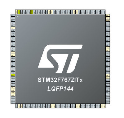

Starting a new project from a board NUCLEO-F767Zi
Rick Hamilton
Using STM32CubeMX version 6.15.0
When I start a new project from the NUCLDO-F767ZI board I just get a blank chip, none of the component configuration at all, I tried it on two PC's both the same.
This used to work and was quite handy starting a new project.  At the moment I am going through a selection of processors so having to manually configure it before I can test it is a bit of a pain, any solutions?

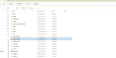

Please try to follow those steps:
- Close STM32CubeMX.
- Delete  the following folder .stm32cubemx  (On Windows: C:\Users\<YourUsername>\.stm32cubemx)
- Restart CubeMX and try again

Thank you for getting back, I have been using that workaround for a while, the fact it also did it on my old PC that I use as a backup and have not been developing on led me to post on the forum.

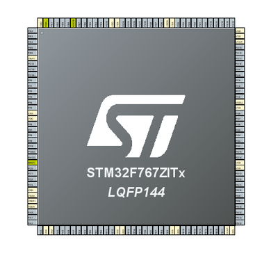

So as you asked, I deleted that directory, re-opened CubeMX and started a project from the NUCLEO-F767ZI and
Same result on both my PC's?
I also tried other processors and tried to start a project from an example some do work but most do not?  Very strange.   This was working 2 days ago, I started a project with NUCLEO-F722 and today its not working.

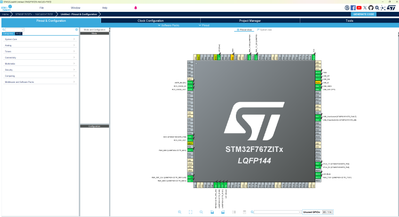

Just as @Ghofrane GSOURI , I am able to create a NUCLEO-F767ZI board project and have all the default peripherals initiated.
  1. Generate code as is and upload the IOC file.
  2. Do an OBS video capture of your steps when creating a new board project and upload the video.

Hello @Rick Hamilton @Karl Yamashita
As  requested @Karl Yamashita I am providing the IOC file along with a video recording of the steps I followed to create a new board project.
THX
