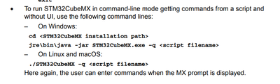

I am trying to setup a build pipeline for the STM32 platform to be able to compile projects in an automated fashion. So far, I have an .ioc file which I use the to generate the project using the STM32CubeMX commands which are invoked via the script in the cli mode. The flow works on an Ubuntu machine which supports GUI. However, when I try to containerize the flow into a docker container, the build breaks as the STM32CubeMX tries to render a progress bar for the Loading IOC step followed by a Rendering UI progress bar. It is not possible to load display components on the docker and hence STM32CubeMX code generation fails. Is there any way to launch STM32CubeMX in a headless non-gui mode so that we can run this on headless machines?
This is the UI that pops up.
The following is the contents of my script file
config load <filename>.ioc
project name app
project toolchain STM32CubeIDE
project path <path>
SetCopyLibrary copy all
SetStructure Advanced
project generate
exit
 Command to invoke STM32CubeMX:
java -jar <path_to_CubeMX>/STM32CubeMX -q <scriptfile>

Hi @BarryWhit
The main reason to raise a concern is because the behavior of the CubeMX tool contradicts the user manual (UM1718).
It explicitly says to run CubeMX "without UI", use this command. However, the said command pops-up a window which is not expected.
There's also the issue where if something goes wrong during batch-mode generation, you get a GUI message box and user interaction is required instead of cube exiting with an error code - which is not cool (and andrew said as much in the other thread).
I agree, the tool should exit gracefully with error codes instead of popping up windows when invoked in non-GUI mode. Hopefully the issues are resolved soon :) We can always try !
