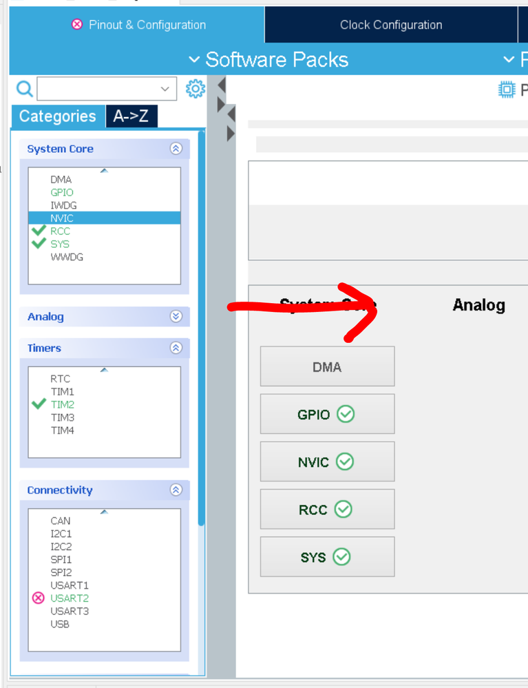

After creating a new project STM32CubeMX it automatically generates code. If I want to change any setting using STM32CubeMX how can it be restarted from within STM32CubeIDE ?
I ran STM32CubeMX by double-clicking the .ioc file, but STM32CubeMX does not show the configuration tabs. What is the proper way to rerun and reconfigure STM32CubeMX ?

It should show up when you double click the IOC. Maybe the panel is hidden or something. Show a screenshot.
If you generated it in standalone mode, you could just redo it there as well.

Here's a screenshot of MX (opened by d-clicking the .ioc file). Same screen shot also attached to this reply.
Note that many of the configuartion tabs and subcatagories are missing.

The tabs aren't missing, they're just collapsed. Drag the vertical bars away from each other to expand.
User code is preserved on regeneration as long as you have the checkbox marked. I'd back everything up beforehand if it were my project, however.

Yes, I have already done this. There are still no tabs for, say, changing the USART2 baud rate, etc.
Where have all the prvious tabs and catagories gone ? (See new attached screenshot)
Guru
There is still another vertical bar there. Drag it right.

Thanks for the help. It's a shame that the panel is completely collapsed.
