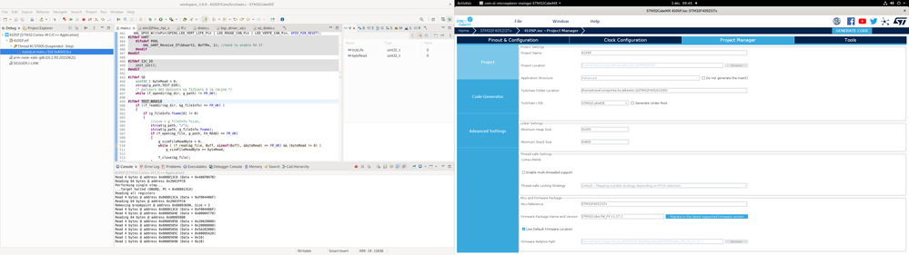

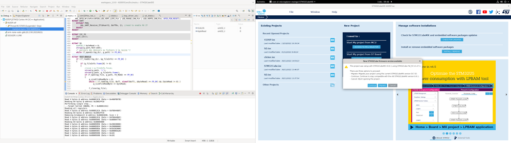

2022-12-01 1:16 AM
update:
MxCube.Version=6.6.1
if i migrate to the new CubeMx 6.7.0, regenerated software and doesn't works.
i passed 3 days to search and i will continue to find problem.
with the new cube mx:
void MX_SDIO_SD_Init(void)
  /* USER CODE BEGIN SDIO_Init 0 */
  /* USER CODE END SDIO_Init 0 */
  /* USER CODE BEGIN SDIO_Init 1 */
  /* USER CODE END SDIO_Init 1 */
  hsd.Instance = SDIO;
  hsd.Init.ClockEdge = SDIO_CLOCK_EDGE_RISING;
  hsd.Init.ClockBypass = SDIO_CLOCK_BYPASS_DISABLE;
  hsd.Init.ClockPowerSave = SDIO_CLOCK_POWER_SAVE_DISABLE;
  hsd.Init.BusWide = SDIO_BUS_WIDE_4B;
  hsd.Init.HardwareFlowControl = SDIO_HARDWARE_FLOW_CONTROL_DISABLE;
  hsd.Init.ClockDiv = 20;
  /* USER CODE BEGIN SDIO_Init 2 */
  /* USER CODE END SDIO_Init 2 */
}//old
 hsd.Init.BusWide = SDIO_BUS_WIDE_1B;
//new
hsd.Init.BusWide = SDIO_BUS_WIDE_4B;  /* Configure SDIO peripheral interface */
  (void)SDIO_Init(hsd->Instance, hsd->Init);
//so use CubeMx parameters for the first initialisation
//the first initialisation must be in 1 Wire. bug in last CubeMx.2022-12-09 7:23 AM
