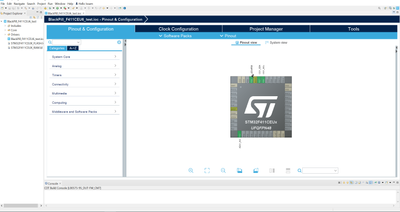

I upgraded STM32CubeIDE to 1.14.0 and then when I went to open an ioc file I got this message:
This project was setup with STM32CubeMX V6.9.2 using STMCube FW_G0 V1.6.1.
There are two options to proceed:
-Migrate:Migrate your project using the current STM32CubeMX version (6.10.0)
-Continue: Continue to stay compatible with the old STM32CubeMX version 6.9.2
I chose the 'Migrate' option, which was probably a mistake. Now when I try to open the ioc file it just goes blank. Any advice please?
ADDED LATER: In the meantime, I tried opening a different project, but selected the 'Continue' option. Again I got a blank tab when I tried to open the  .ioc file
Dabbo
OK, I seem to have solved the problem by using X11 instead of Wayland.
I remembered that to get the previous version to work I had to change the .desktop file to use X11 instead of Wayland. I have now done the same thing for version 1.14.0 and the MX configuration program now works.
I can't say I understand it - but it's working.
Thank you responders!

What is the current version of your installed STM32G0 FW ?
Have you tried to force the tool version by hand in the ioc file ? I know this is not always recommended and could be risky, but this could be worth trying...
Restarting PC - same problem.
Purged the STM32CubeIDE package from system and re-installed - same problem.
I'm puzzled by the message that said  "This project was setup with STM32CubeMX V6.9.2 using STMCube FW_G0 V1.6.1" as this device is F411CEU6 not the G0 series. Is that a clue to the problem?
