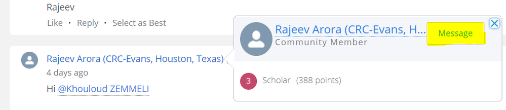

Hello @Rajeev Arora​
Just put the cursor on my name, then you will find a Message button, as mentioned in the image below, simple click on it, you can send me your project there.
0693W00000D1spWQAR.pngIf you still face a problem, don't hesitate to tell me :)
