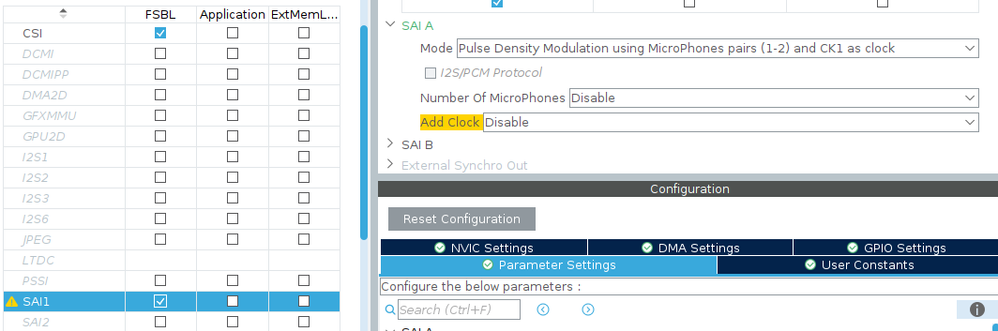

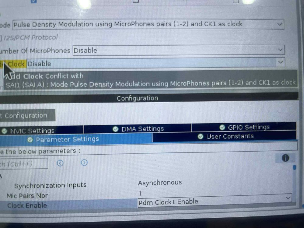

pdm gives conflict warning for NUCLEO-N657X0Q!
ninjatuna
1 REPLY 1
Souhaib MAZHOUD
Hello @ninjatuna
This warning is normal because CK1 has already been selected and you can only choose CK2.
