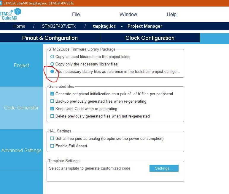

hi
In CubeMX, Project manager, Code generator tab check the third option, to add all theese libraries as reference and not copy them.
