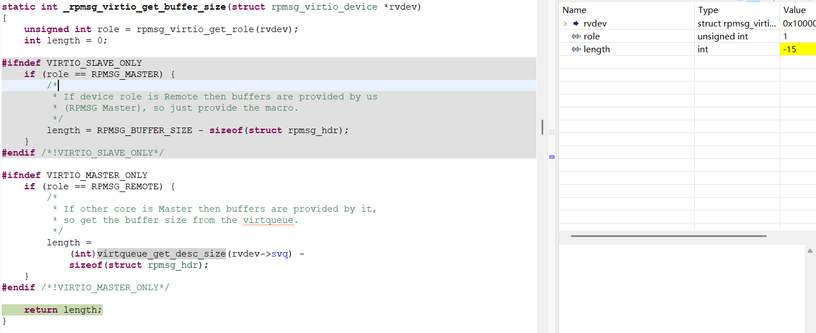

Through debugging, it was found that the problem lies in the OPENAMP_create_endpoint() function in the M4 core. The return value is -2005, but as a beginner, I am unable to pinpoint where the problem lies. I will attach my project at the end of the article.

Hello, after several days of trying and using the same code, I found that CUBEIDE1.16.0 can communicate normally, but the latest version 1.18.0 cannot communicate normally, and the error code is RPMSG.BUUFFER-ERROR=-2005. I will provide the corresponding engineering file in my answer. Please check if there is also such an error on your device. If so, could you please submit this bug?

Hello, 745_AMP is configured using CUBEIDE1.16.0 and the code is running normally. AMP_745 is configured with CUBEIDE1.18.0 and the code runs abnormally. CUBEIDE 1.16.0 uses the firmware FW_1.11.0 of H7, while CUBEIDE 1.18.0 uses the latest firmware. After you successfully submit the bug, I will set the answer you successfully submitted as the best response. I will include my debugging information and error code at the end of the article.
static int rpmsg_virtio_send_offchannel_raw(struct rpmsg_device *rdev,
                        uint32_t src, uint32_t dst,
                        const void *data,
                        int size, int wait)
    struct rpmsg_virtio_device *rvdev;
    struct rpmsg_hdr rp_hdr;
    void *buffer = NULL;
    unsigned short idx;
    int tick_count = 0;
    unsigned long buff_len;
    int status;
    struct metal_io_region *io;
    /* Get the associated remote device for channel. */
    rvdev = metal_container_of(rdev, struct rpmsg_virtio_device, rdev);
    status = rpmsg_virtio_get_status(rvdev);
    /* Validate device state */
    if (!(status & VIRTIO_CONFIG_STATUS_DRIVER_OK)) {
        return RPMSG_ERR_DEV_STATE;
    if (wait)
        tick_count = RPMSG_TICK_COUNT / RPMSG_TICKS_PER_INTERVAL;
    else
        tick_count = 0;
    while (1) {
        int avail_size;
        /* Lock the device to enable exclusive access to virtqueues */
        metal_mutex_acquire(&rdev->lock);
        avail_size = _rpmsg_virtio_get_buffer_size(rvdev);
        if (size <= avail_size)
            buffer = rpmsg_virtio_get_tx_buffer(rvdev, &buff_len,
                                &idx);
        metal_mutex_release(&rdev->lock);
        if (buffer || !tick_count)
            break;
        if (avail_size != 0)
            return RPMSG_ERR_BUFF_SIZE;<-------The problem lies here

Hello @MECHO ,
In fact the issue has been already reported in this post.
In fact in your non-working project, you have this warning:
<command-line>: warning: "RPMSG_BUFFER_SIZE" redefined
<command-line>: note: this is the location of the previous definition
So in conclusion:
You have two issues from the beginning:
- You didn't update the linker files to allocate memory for OpenAMP.
- An issue with the generated code with STM32CuebIDE 1.18.0 (a regression from older versions)
mƎALLEm
Issue fixed in CubeMx 6.15.0
