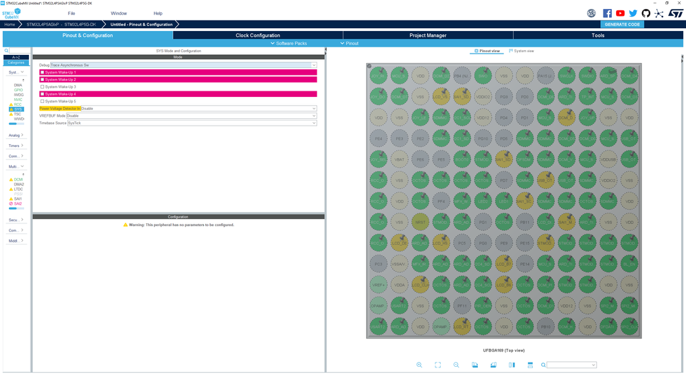

Open Initialize all peripherals with their default Mode after selecting Yes, DEBUG without serial wire option

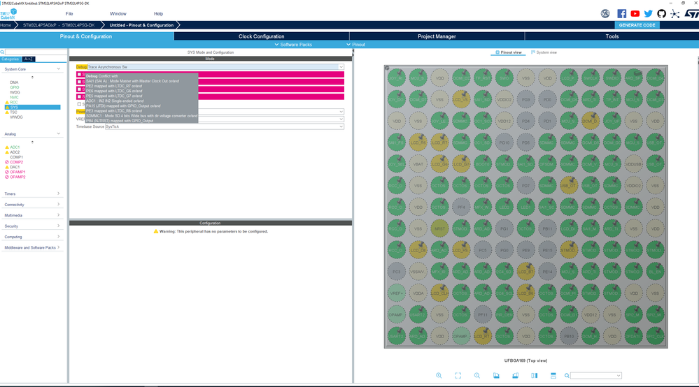

Hello @�?�兵 何​
Let's try this solution:
As shown in the screenshot , we need to eliminate the conflicts in order to make the "Trace asynchronous Sw" is the SWD (serial wire), works correctly
After solving the conflicts :
I will be waiting for your feedback
Thx
Ghofrane

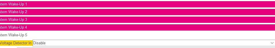

‎2023-05-07 1:11 AM
"Trace asynchronous Sw" is the SWD (serial wire), with additional SWO pin. So this is OK.
The red colored things are not relevant.

@Pavel A.​ I understand what you mean, however, I exported to keil via GENERATE CODE and it will not work after burning to the development board in keil.

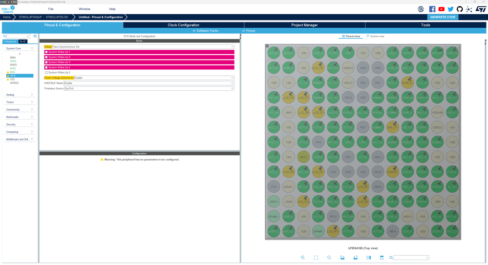

‎2023-05-08 3:03 AM - edited ‎2023-11-20 6:14 AM
Hello @�?�兵 何​
Thx
Ghofrane
‎2023-05-08 4:18 AM
@Ghofrane GSOURI​
Thank you very much indeed, the problem is solved!
