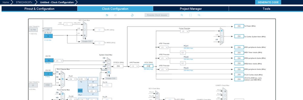

CubeMX bug: Can't set H5 clock speed to 250 MHz (eg. H562IITx) "Frequency searched for is out or range."

Hello @Community member​ ,
I couldn't reproduce this issue :
Foued
UStre.2
ok thank you for the hint, but shouldn't the "resolve" solve that?
Regards
Uwe
You may choose the right combination to reach 250MHz.
  1. PLL1 source Mux : HSI
  2. System Clock Mux : PLLCLK
some pre-configured interfaces (import from old MCU) limit the max frequency to 200 MHz.
We are working it, but thank you for the hint.
Regards
Uwe
