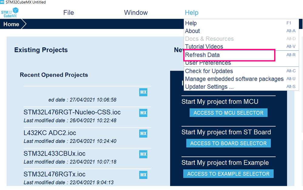

I use STM32MxCube to install example code. I selected STM32H7 to finde the Nx_Iperf example for the STM32H747I-DISCO board. When I select Start Project, the progress bar runs to completion then I get a message "FAILED TO INSTALL EXAMPLE: Nx_Iperf".
STM32MxCube works for other examples, such as Nx_SNTP_Client.
How can I install this code?

Hi @EBerl.1​ ,
This is because the Nx_lperf is removed from the list of MCU selector examples.
To have the last update of the list, please do a Refresh Data :
If your question is answered, please close this topic by choosing Select as Best. This will help other users find that answer faster.

‎2021-04-29 3:17 PM
That answered it. Thank you.
