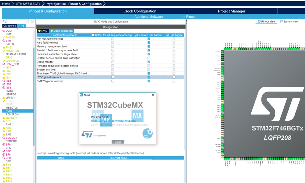

NVIC Code Generation feature does not seem to be working correctly.
RRoon
I'm using STM32CubeMX 5.4.0.
When I enable LTDC and DMA2 interrupts (for example) in the NVIC tab in NVIC Mode and Configuration, when I switch to the Code Generation tab there are no entries for either LTDc or DMA2D. See attached screenshots.
What is preventing Code Generation ?

Khouloud ZEMMELI
​Hello @RRoon​
could you please share your ioc file?

Sure Khouloud. See attached.
Khouloud ZEMMELI
With your ioc file :
please ​move the scroll bar I think they are at the end of the table.
Best Regards,
Khouloud
RRoon
Thanks Khoulid,
they weren't there, but when I exited and re-loaded they appeared .
Thank you again,
