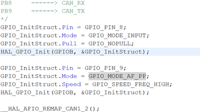

I have stm32 bluepilll on which I am able to transmit CAN messages but CAN Receive interrupt is not generating.

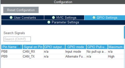

I found while configuring that CAN RX pin(GPIO mode) is getting configured as Input mode. How accurate is this?
I  think it should be Alternate function. I made PB8 as Alternate function still CAN Rx interrupt is not working.
Above statements are under stm32f1xx_hal_msp.c

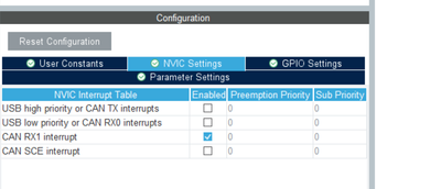

I am using CAN RX1 interrupt, following are  my configurations

HAL_CAN_ActivateNotification(&hcan,CAN_IT_RX_FIFO1_MSG_PENDING);

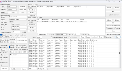

I have an USB to CAN analyser, I am sending a CAN message under while loop which I am able to see on my PC.
From the same analyser I am sending a CAN frame whose ID is being checked under callback function.
Try to transmit message from MCU and see if you are receiving messages may be at 1sec or 100msec on the tool.
This messages are transferred from MCU.I am able to see them on PC.
