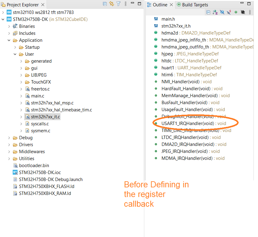

ksale.1
Senior II
I used the legacy code successfully using MVP (Model View Presenter), but lost my way with the new approach , I would like to have an App note about it and/or examples.

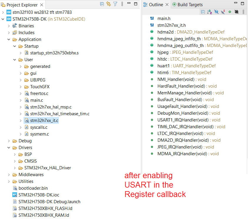

ksale.1
Senior II
Thank you @Pavel A.​ , please note the below sceenshots
Please note I couldn't locate the file stm32h7xx_hal_conf.h in the project tree. Please advise.
After enabling the callback you still have the USART1_IRQHandler.
The stm32h7xx_hal_conf.h should be in Core/Inc (or maybe generated/Inc for emWin projects). Use dir /s command to find.
