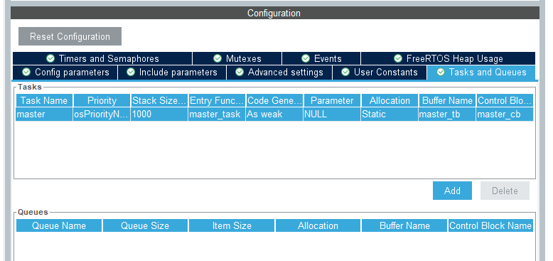

We are using CubeMX (incl. FreeRtos) to update our settings.
The problem is that CubeMX will always create a default task in the main. We also tried to remove the following line from the ioc file "FREERTOS.Tasks01=defaultTask,0,128,StartDefaultTask,Default,NULL" but it will automatically rewrite it.
Is there a way to disable the default task code generation ?

Hi, I use the latest version integrated in cubeIDE not stand alone cubeMX, but I assume is uses common framework. Here is the picture with single task that can not be deleted.
0693W00000SuUTcQAN.pngIn generated code I can put the #if 0 to prevent to remove the task from being created. Because it is in used code section it will survive the regeneration. However it is completely dependent on generator template which can change with any update so it is no way a solution of the problem. Just a hack for of current version.

 the processor is stm32g071 but it is probably the same for entire g0 family or eve f0 famil. All of them have just few kB of ram
