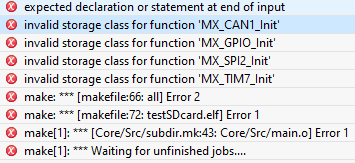

Including FATFS with CubeMX breaks everything.
Javier1
Principal
Using an stm32f105RBt6 :
  • i have a working project with canbus and USBdevice.
  • i have another working project with canbus and FAtFS(SPI-sd card)
None of them work once i include FATfs+USBCDCdevice
i dont know what to make up from this, last time i had a similar error i had messed up my include logic.

If the compiler says MX_GPIO_Init isn't defined, it's probably not defined. Perhaps you are missing brackets. Hard to tell with the limited information you've provided. If you attach the full main.c file I'm sure the error will be spotted.

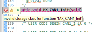

@TDK​ You were right, i checked and they are defined but for some reason the compiler throws this error.
Just to clarify, this are all generated by CubeMx i didnt touched them.
The error was not there before i tried to include FatFs (or i tried to include USBCDC in another working FatFs project)
I also checked the "expected declaration..." error, i didnt change anything at all.... i dont think cubeMx missed a ";"0693W00000LzMwcQAF.png

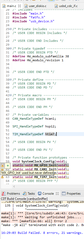

You are missing a closing bracket in the USER CODE 3 section to close out the while loop.
  /* Infinite loop */
  /* USER CODE BEGIN WHILE */
  while (1)
    /* USER CODE END WHILE */
    /* USER CODE BEGIN 3 */
		  TransmittingAtruntimeUSB(&htim7);
		  CANBUSfiletransfer();
  /* USER CODE END 3 */
The content in the USER CODE sections contradicts this.

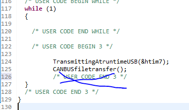

found the issue, thanks for your help @TDK​
I must had copy pasted at some point since the last cubeMx generation the label Inside the while(1) loop by mistake,
this was confusing cubeMX
0693W00000LzQc7QAF.pngI removed the extra label and everything works

Maybe i didnt explained myself correctly, i didnt missed any brakets.
As i explained in the previous comment :
with all the brakets in its correct place ...i accidentaly duplicated the comment label
This made the autogeneration from cubeMx confused and *ate* the last main() closing braket every time i tried to autogenerate the code.
