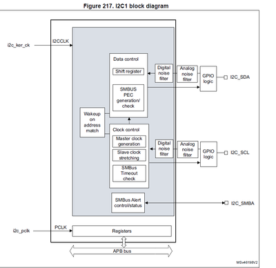

Also i want to ask about the I2C clock diagram, because i see that the source clock for the I2C is not the same as for the registers, maybe i'm forgetting something needed to match between I2C and registers while modifying de frequency?
This block diagram is from de STM32F042F6P6 reference manual
thanks!
