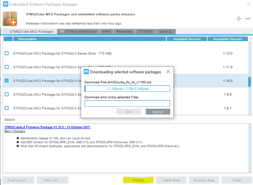

I am using CubeMX v6.2.1, when I attempt to install the L4 MCU package v1.10.0, I get an "HTTP Access Forbidden" error. I am seeing the same error on Windows and Linux.
I can download v1.9.0 and v1.11.0, and v1.17.0 without issue. The error only seems to happen with v1.10.0.
I am attempting to update a project from v1.8.0, however, the CAN API changed in v1.11.0, so wanted to upgrade to v1.10.0 as the most recent update prior to the CAN API change.

Could you try please to do a Refresh before starting the download of the firmware package. This will refresh STM32CubeMX database with STM32 MCU latest information and so the list of available package versions.
Hope this helps you solve your issue.

‎2021-06-16 12:51 PM
Thanks for the response. I have tried refreshing before attempting to download.

‎2021-06-18 7:18 AM
Hi @Community member​ ,
Thank you for those inputs.
Actually, the problem was related to the download server sw-center.st.com when dealing with large files (the size of STM32Cube_FW_L4_V1.10.0 folder is almost 1.8GB).
Normally the issue is fixed and you can download successfully STM32Cube MCU Package for STM32L4 series version 1.10.0.
Could please give it another try and keep me informed if there is any progress.
Khouloud.
‎2021-06-18 2:17 PM
It is working now, THANK YOU!
