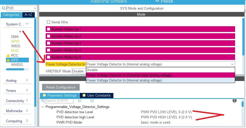

I am working on STM32G0 Nucleo Board with STM32 Cube IDE 1.3.0 .
How to Use STM32G0 Power Voltage Detector (Internal ) with STM32CubeIDE ?
I want my MCU should only start when Voltage goes above 2.5V (Say)..0693W000001sh8tQAA.jpg
The above setting nothing generate in .c file for PVD.
I have also checked below example but nothing configured in PWR_PVD.ioc
..\en.stm32cubeg0\STM32Cube_FW_G0_V1.3.0\Projects\NUCLEO-G071RB\Examples\PWR\PWR_PVD
Thanks in advice ..
Any Other option..
Karan
Khouloud ZEMMELI
Hello @Community member​
From CubeMX side, you need to change PVD level, the 2.5 V is present in parameter options.
