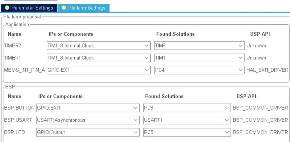

how to use algobuild in cubemx?
2020-11-17 9:11 PM
I tried but it didn't work.
these setting is right?
it makes error at TIM_AB_Config()
Has anyone succeeded to use x-cube algobuild?

Hello @kdok .1
Could you please share your ioc file ?
Thanks
Khouloud
2020-11-18 9:11 PM
2020-11-20 6:56 AM
Hi @kdok .1 ,
Using your ioc file, there's a many compilation errors
It will be internally checked, thanks for your feedback.
Regards,
Khouloud
2020-11-20 7:03 AM
there's an example under repository which use ALGOBUILD , it may help you : \Repository\Packs\STMicroelectronics\X-CUBE-ALGOBUILD\1.1.0\Projects\STM32L152RE-Nucleo\Applications\IKS01A3\NUCLEO-L152RE_IKS01A3
