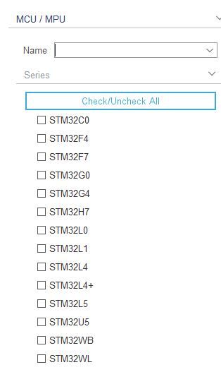

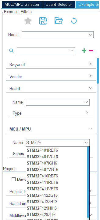

Dear all,
Could you tell me how to get some samples of STM32F103C8T6 in STM32CubeIDE?
0693W00000UnEKrQAN.pngThanks

Availability of parts/samples about ZERO at this point.
Software Examples, perhaps look in the CubeF1 download/repository, should be buildable projects in there. F1 parts are very old, and not a priority, they may not be strong driver to convert to .IOC based projects. Most would have be hand coded by engineers.

Hello @BLu.1​ ,
The Examples are not available for all families.
Only the following series are supported:
Imen
