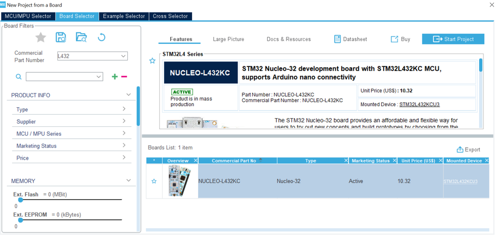

I will show you how to get started making a program (blinky) for an STM32 microcontroller using C++ on STM32CubeIDE.
I will use an ST Nucleo-L432KC for this demonstration, as it’s small, fits on a breadboard, and still has a powerful ARM Cortex-M4 core. You are welcome to use any STM32 part, but I generally recommend starting out with one of the Nucleo boards.
Plug your STM32 part into your computer.

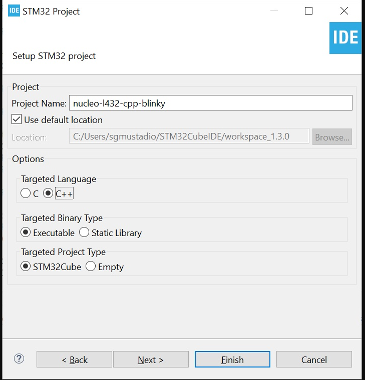

Start STM32CubeIDE[link] and select File > New > STM32 Project. Select your target microcontroller or board (I’ll select my Nucleo-L432KC).
Click Next and then give your project a name. I like to prefix the board I’m using to the project name, so nucleo-l432-cpp-blinky is what I called mine. In Targeted Language, select C++.
Click Finish and click Yes when asked, “Initialize all peripherals with their default Mode?�? Click Yes to open the new perspective.
Leave everything as default on the CubeMX device configuration GUI.

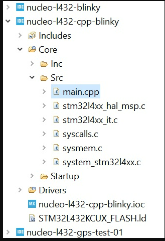

Code should be automatically generated. However, CubeMX generates a main.c file, which is not what we want for a C++ project. Right click on <project name> > Core > Src > main.c and select Rename. Change the name of the file to main.cpp. The compiler is sensitive to file suffixes, so .c files will compile as C code and .cpp or .cc files will compile as C++.

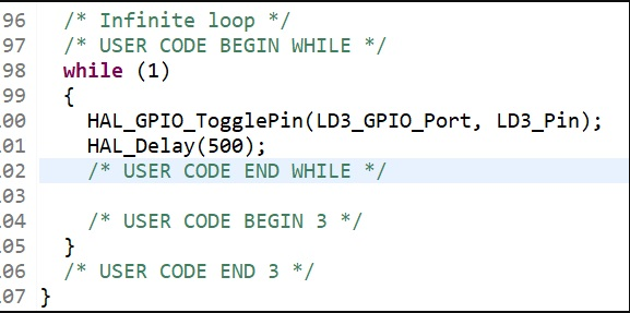

Open the main.cpp file associated with the project. Scroll down to the while (1) loop and add the following code just inside the while (1) loop:
HAL_GPIO_TogglePin(LD3_GPIO_Port, LD3_Pin);
HAL_Delay(500);

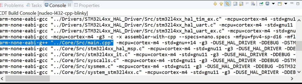

Save and click Project > Build Project. You should notice that any .cpp or .cc files get automatically built with g++.
Click Run > Debug and click OK to accept the default launch configuration properties. Accept any prompts you might see to open the debug perspective. Click Run > Resume, and you should see the LED begin to blink.

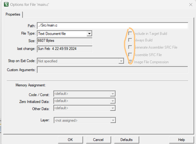

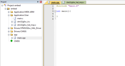

2024-02-04 9:55 AM - edited 2024-02-06 2:20 AM
The above description works fine with STM32CubeIDE.
But when I try to add the same thing with KEIL uVision it gives a lot of error messages.
I'm generating my file in STM32CubeMX for Keil and then disabling the main.c build and adding main.cpp file

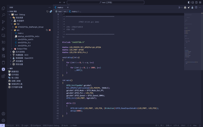

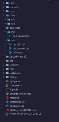

2024-04-29 12:16 AM

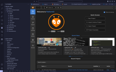

You can use the entensions named platformio or eide in VSCode, they are both support STM32
As for using C++ in embedded projects, this is certainly possible.
Next, I'll use platformio to implement mixed C/C++ programming in projects generated by STM32CubeMX.
First, generate a template project with makefile, cmake or other which using arm-none-eabi-gcc.
Second, open the folder with VSCode, add a file named "platformio.ini" in root directory, and Incorporate the following:

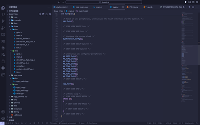

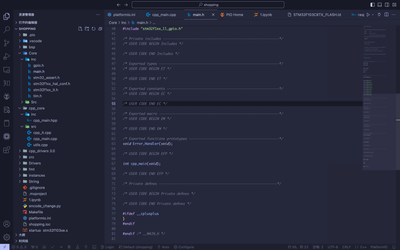

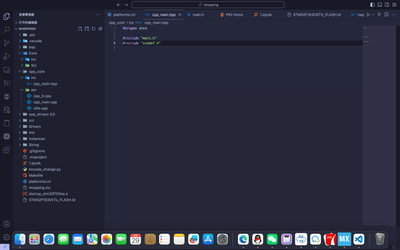

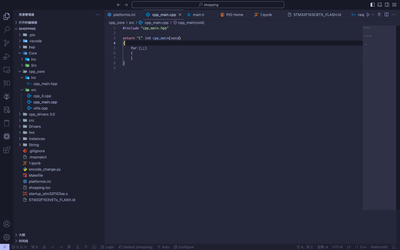

Second, add a folder(any name, I named it "cpp_core") with 2 subfolders named inc, src, and add new files cpp_main.cpp, cpp_main.hpp, cpp_it.cpp here.
Third, include "main.h" in cpp_main.h, add the defination of a function named "extern "C" void cpp_main(void)" in cpp_main.cpp, and its declare in main.h(not cpp_main.hpp). Add the function in your main function.
Now, You can use "cpp_main" as your new main function in C++.

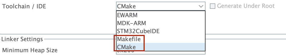

2024-10-29 10:51 AM
Hi, since now there is an official STM32 VS Code extension (with CMake), is there a way to configure the STM32CubeMX to develop in C++?
2025-01-09 2:31 AM
That's not the question. How can STM32CubeMX support C++ ?. It does not matter on which IDE we would like to develop.
