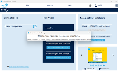

How do I login MX program?
TaehwanChoi
I am a beginner.
How do I login?
I can't login MX program.
5 REPLIES 5
mÆŽALLEm
Hello @TaehwanChoi and welcome to the community,
As shown by the message you need an internet connection to login.

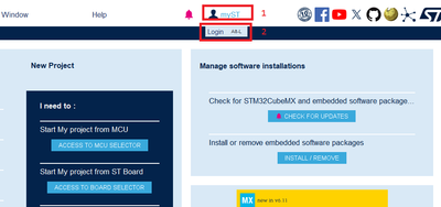

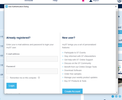

Then login:
But you need first to create a profile in st.com. or click on Create Account button;

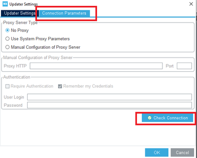

You can connect either with WiFi or Ethernet cable or even 4G/5G.. no matter the media is .. the most important is the internet connection.

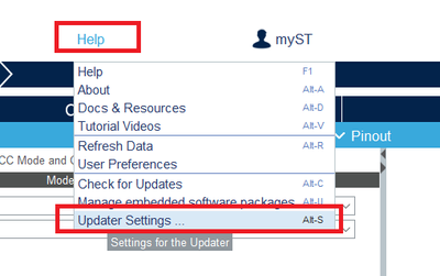

Try to check CubeMx internet connection:
then go to Connection parameters and click on "Check Connection". You need to get a green status like shown in the following figure:
Otherwise check your proxy parameters. In that case try to select select "Use System Proxy Parameters".

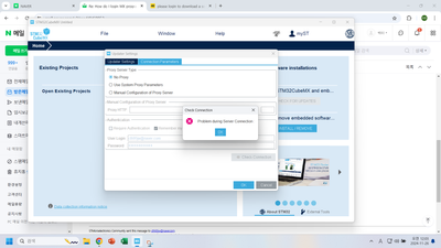

Sorry I am late.
I have a problem yet.
as below picture,
I really would like to use your board(F103-RB).... I don't know why i have a problem....
Could you please uninstall that version and install the latest one: V6.13.0
Check if you have a good internet connection. Otherwise you need to check with your IT the proxy parameters.
