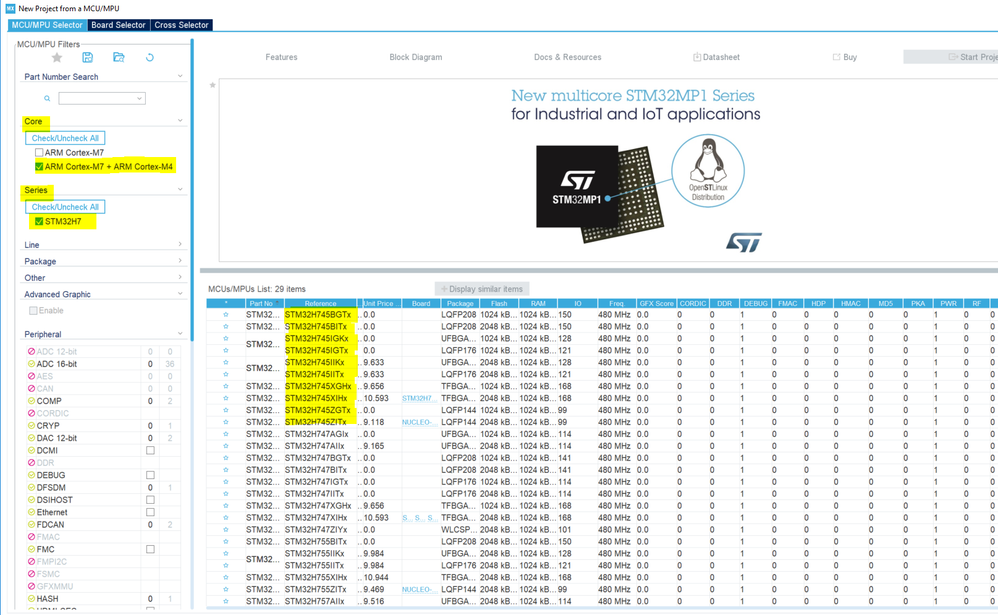

Khouloud ZEMMELI
​Open CubeMX - Select " Access to MCU selector" then:
