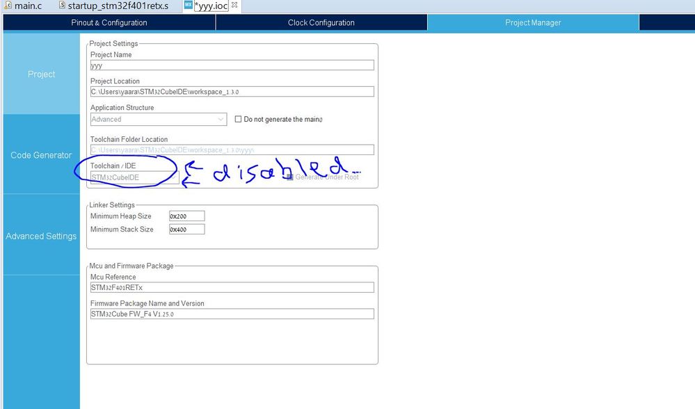

hi the "toolchain/ide" category under project manager options is disabled in stm32cube, someone knows how to solve it? i want to change the toolchain to MDK-ARM and i can not now becuse it is disabled.

It looks like you're opening an .IOC file within STM32CubeIDE, so the choice is locked to STM32CubeIDE.
Open the IOC in standalone STM32CubeMX.

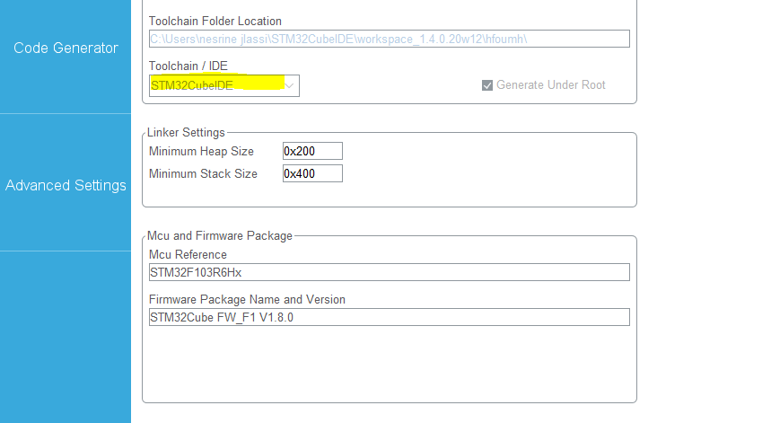

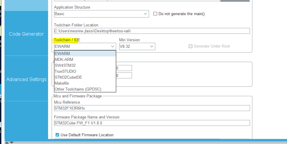

​Hello @YBuch.1​
When you create an STM32 project from the CubeIDE you can only use STM32CubeIDE as Toolchain/IDE (you will notice that only CubeIDE exists and that it is greyed out).
Otherwise, if you create a new .ioc from STM32CubeMX you can choose the IDE that suits your needs.

Hi @YBuch.1​
Download and install STM32CubeMX from here:
https://www.st.com/content/st_com/en/products/development-tools/software-development-tools/stm32-software-development-tools/stm32-configurators-and-code-generators/stm32cubemx.html
Create an .ioc from STM32CubeMX then, you can choose the IDE that suits your needs.
