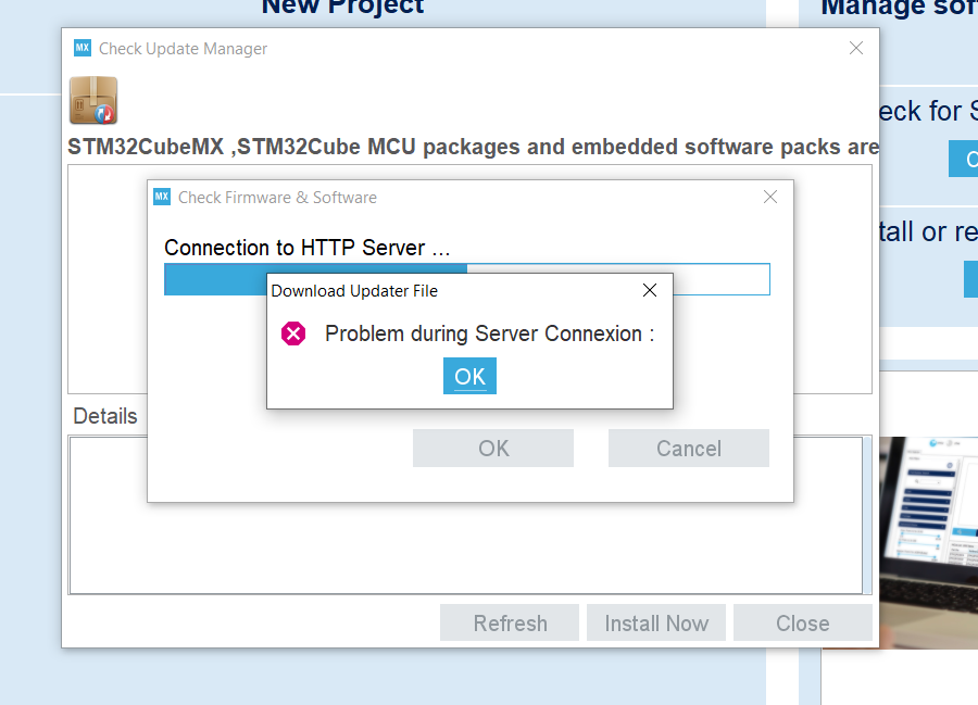

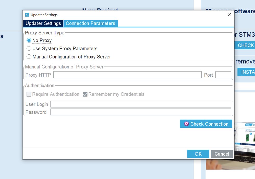

Hi, I have problem showing in those following pictures. I have turned off all of my proxy. So can you please help me what I should do? My firmware package name and version is STM32Cube FW_F0 V1. 10.1 Mcu reference is STM32F030C6Tx

So perhaps you have issues with the internet, things like firewalls, regional blocking, AV software, etc?
Go download the CubeF0 package separately, and apply manually using the "From Local" button.
