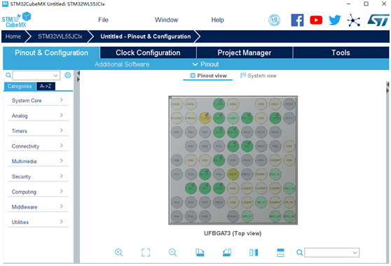

I have use stm32CubeMx for code generate.
In a new version I cannot find the generate code button.

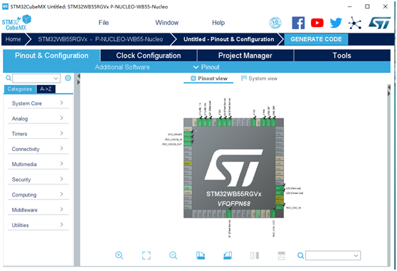

but the new one is none

ver5.6.1 can not use the stm32WL, I used the STM32CubeMX 6.99.1-D37 version ,

Khouloud ZEMMELI
​As disccued with @Community member​ , the official CubeMX version will be available to download w28 from site  (which supports the WL)
Best Regards,
Khouloud
Khouloud ZEMMELI
​@Community member​  WL will not be supported in 6.0.0, it will be for 6.1.0.
Best Regards,
Khouloud
