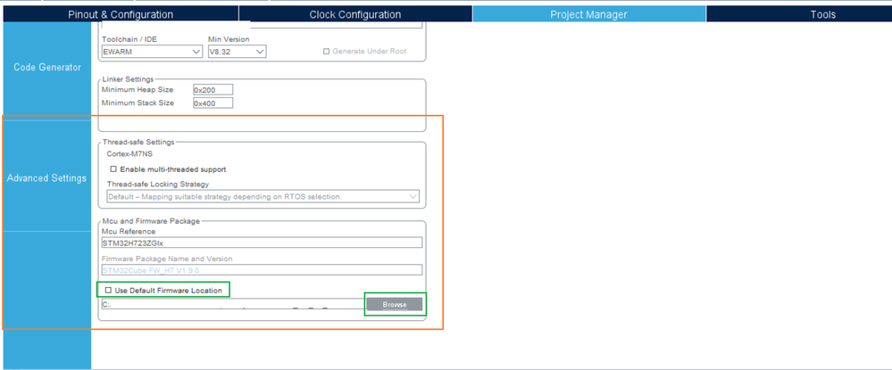

HAL �?��?�브러리 LPTIM 소스 보는�?� �?�전�?는 없었는�?� 최신 HAL �?��?�브러리�? 소스가 새로 �?겨서 ENABLE 하는 부분�?서 TIME_OUT 걸려서 return �?�어서 빠져나가는�?� �?�전 버전�?서는 그 부분�?� 없어서 잘 �?�작했는�?� cubeMX�?서 Firmware Package Name and Version�?서 수정하려고 해�?� 강제로 막혀있어서 수정�?� 불가능 합니다. 해결 방법좀...

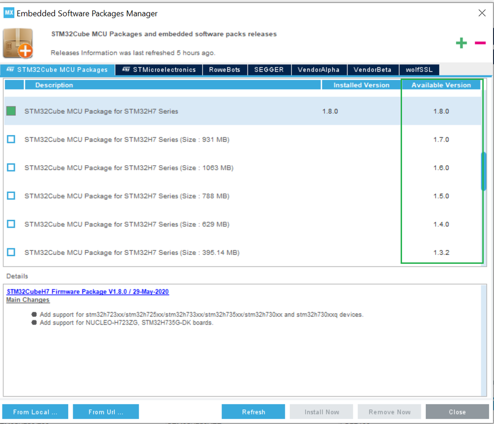

Assuming that you're using STM32CubeMX tool to generate your project, you can download STM32 MCU packages following the steps below:
  1. Select Help > Manage embedded software packages to open the Embedded Software Packages Manager. All the packages available for download are displayed along with their version including the version currently installed on the user PC (if any), and the latest available versions.
  2. Click the checkbox to select a package then “Install Now�? to start the download.

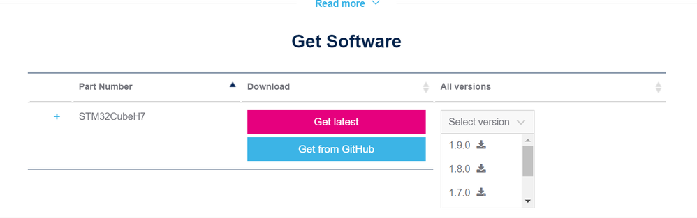

Moreover, you can also download STM32Cube MCU & MPU Packages needed for you application and select the version you want to work with through this link :
Once you've downloaded the STM32Cube MCU Package for your MCU , you can deselect the Use Default Firmware Location checkbox and browse the path for the downloaded firmware which will be used for you project:
0693W00000D0UHnQAN.pngYou can refer to STM32CubeMX User Manual for further details.
