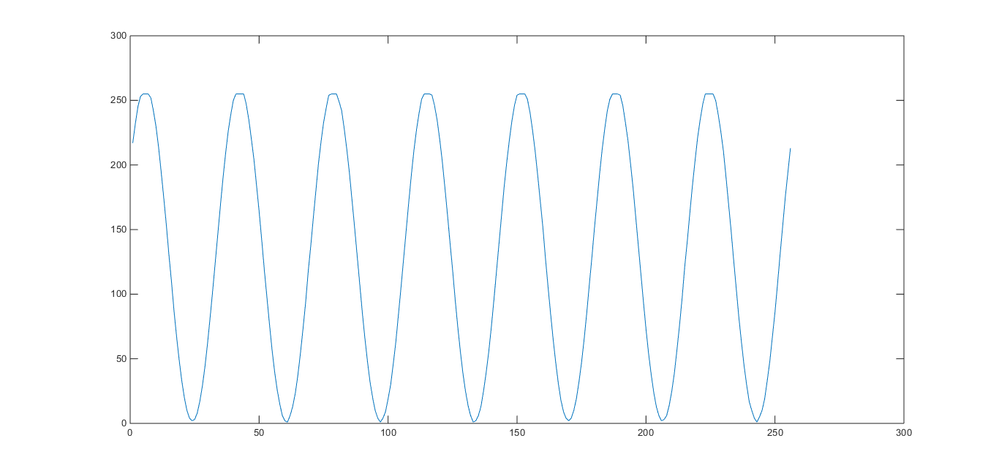

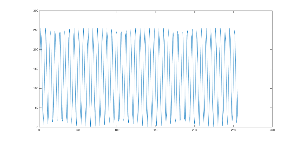

I have change sample cycle from 480 to 28. it works very well till frequency of 1KHz. Above that it start to degrade. I change ADC clock in order to make higher sample rate but it fails, even decreasing ADC clock make it worse!
Approximately the sample rate is :
(ADC prescaler=8 and prescaler peripheral clock=2)
sample rate= 168MHz/(2*8*28)=375 KHz
1KHz input
6KHz inpu
