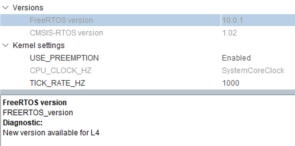

When I click on the little "i" (info) icon in the FreeRTOS configuration screen in CubeMX, I get the following message:
Current version shows as 10.0.1 and under Diagnostic, it says "New version available for L4". Indeed, I checked on FreeRTOS website and the current version is 10.1.1.
How can I upgrade to the newer version in CubeMX? I think the obvious choice is to manually copy/paste files directly from FreeRTOS repository and hope for the best but every time I update CubeMX project, it will get overwritten by the 10.0.1 version.
I checked thoroughly everywhere in CubeMX (version 5.0) with no signs of how to upgrade. Is this even possible?

Far too late to help you, but for the rest, I managed to get it to upgrade FreeRTOS by opening CubeMX directly instead of the STM32Cube. Just be careful that the MX versions match.
