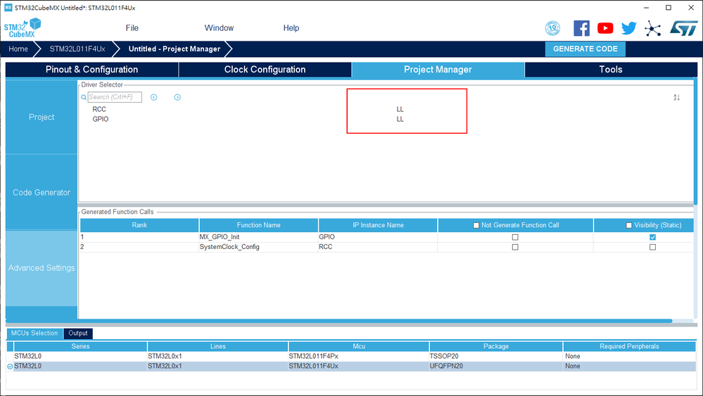

Does STM32CubeMX 5.3.0 supports LL code generation for STM32L0xx series? Thanks.

Yes. Change from HAL to LL in the "Project Manager" -> "Advanced Settings" tab.

On the left side, there are 3 tabs. You have the "Project" tab selected. Click on "Advanced Settings".
Yes, the UI is horrible.

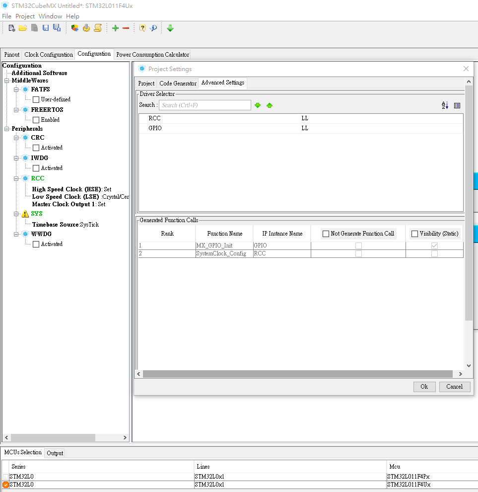

Hi TDK,
STM32CubeMX V4.27.0 is the last version I found that supports LL. see picture blow.

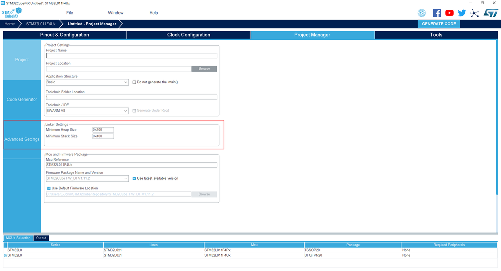

Did you click "Advanced Settings" on the left like I suggested? It works, I tried it. Make sure you have the latest STM32L0 package.
E-John
Hi TDK,
Yes, the different setting page appears after clicking the "Advanced Settings", like below.
