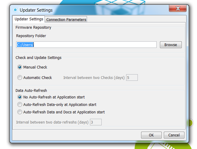

Like a lot of modern desktop computers I have a small, fast system disk and a huge data disk. This means that I really don't need gigs of Repository on my system disk, I want to choose where it goes.
In CubeMX 4.25.0, the Help->Update Settings->Repository Folder is greyed out.
Can this facility please be enabled so I don't have to keep manually moving downloaded HAL libraries and having to change the Repository path for every new project?

It's not greyed out in my case. Could you please share a screen shot showing the issue.

You can change the repository path only if there is no project loaded.
Please close your current project then change your repo path
