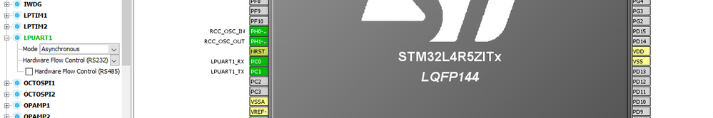

Hi CUBEMX Team,
for NucleoL4R5ZI
LPUART1 is taking as GPIOC port.
It has to be GPIOG port.
Please fix this
Thanks
Phanirajkiran
#cubemx #bug

Posted on May 16, 2018 at 17:05
Hi Imen,
When  i clear pinouts and select LPUART it will go to GPIOC instead of GPIOG.
Thanks
Phanirajkiran

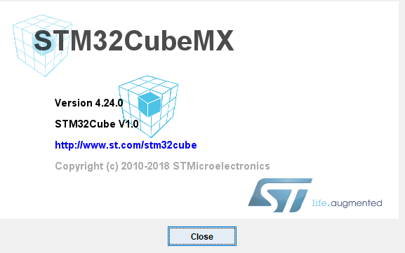

Posted on May 16, 2018 at 17:12
V4.24.0 is NOT current, try using the current version to confirm if the issue exists or has been fixed in the intervening months...
Nawres GHARBI
Posted on May 21, 2018 at 11:10
Hi
Phanirajkiran,
When loading the board, please select init peripherals and the LPUART will be at the right port.
Enabling manually the peripheral will select the first available port and not the dedicated one on the board
