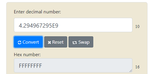

4.294967295E9 and 4294967295 are equal. One is expressed in scientific notation. Though certainly an integer would be preferable here.
