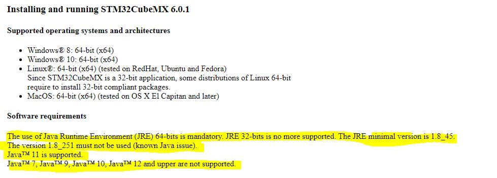

SSaxe.1
Hello All,
I faced the same issue and I solved my problem on my own.
You guys might be facing the issue due to same reason.
Please Follow these steps.
  1. Whatever version it is, please read the Readme.html for that particular version and check the java requirements.
  2. Say for example i downloaded v 6.0.1 and hence it was not supporting the java version which was installed in my PC.
  3. See this
0693W000002li0gQAA.jpg4. After matching the java version, please restart the PC(This is important).
5 Still doesn't work ? Uninstall completely including program data and settings and follow the above steps.
