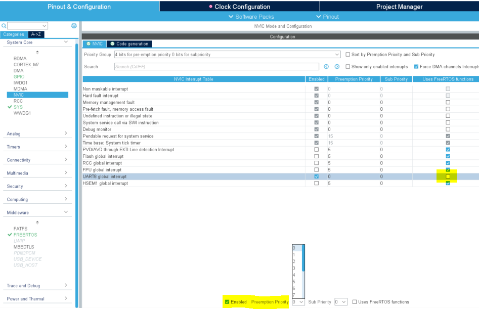

I have been working on a FreeRTOS project for the last six months and all was going well until the last STMCubeIDE & CubeMX update.
Rightly or wrongly, I have been using the usarts with the below interrupt config
/* UART8 interrupt Init */
HAL_NVIC_SetPriority(UART8_IRQn, 0, 0);
HAL_NVIC_EnableIRQ(UART8_IRQn);
Preemption = 0.
After the last CubeMX update, my four uart comms no longer worked.
After much digging, I found that the CubeMX was setting the Uart Preemption = 5, thus generating the below code.
HAL_NVIC_SetPriority(UART8_IRQn, 5, 0);
When it is set at 5, my code no longer works. The uart interrupts do not respond at all.
A value of 5 appears to be a reasonable value or even in the range of 5..15.
Why does my code no longer work??
P.S. I used the CubeMX builder for the original project design and used it's defaults.
It would appear that all Preemption's = 0 not just the Uart channels.
Solved! Go to Solution.

Hello @NW27​
Thanks for your feedback,
Well, when FreeRTOS is enabled the Preemption Priority changes.. if you want to set your IP preemption priority to 0 (or other value less than 5) you need to uncheck its "uses FreeRTOS functions".

‎2020-11-25 1:07 PM
Thanks for your reply.
I understand why the CubeMX is changing it but my question is as to why changing it to 5 from 0 would stop the Uarts from working?
‎2020-11-27 1:29 AM
It may depends on your application and some configurations .. as a workaround, you can change the priority as mentioned in the first comment if it suits you.
