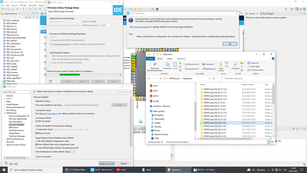

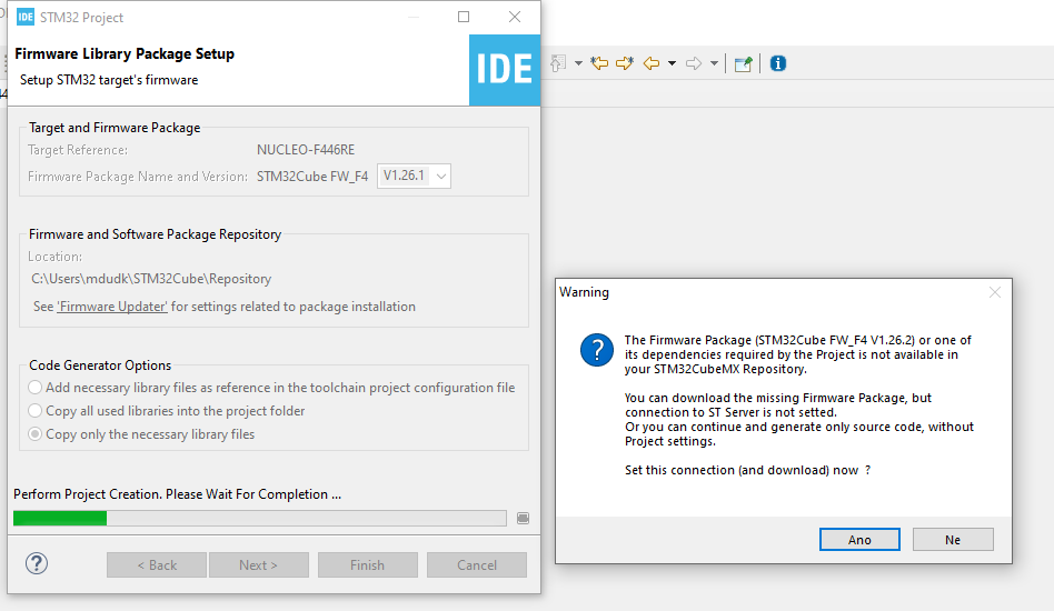

i want to generate new projetct (in CubeIDE) with older firmware package version (in that case with F4_V1.26.1). In window firmware library package setup, i select V1.26.1 and click finish. Cube show warning about missing V1.26.2 (ok, but i want use 1.26.1) - see on screenshot. I will choose not to download 1.26.2. In next step Cube say that "Code generation could not be done..." (see next screenshot). And yes, code generation fails. But desired version V1.26.1 is in repository, repository folder path is correct (many succefuly generated projects proove that).

Support for older library versions is quite poor. There is a CubeMX component in addition to the firmware package that is used and newer CubeMX versions don't like to use older package.
If you don't want to upgrade, keeping the IDE version and CubeMX version the same is the only surefire way.
It doesn't seem to be a priority by ST to keep older projects working correctly without upgrading to the newest library version.
