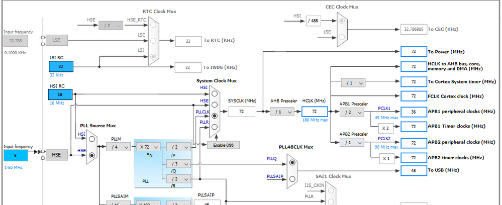

Still very fresh with CubeMX and all this STM32 stuff, hope it is my fault. Or not?
In the Clock configuration tab in Cube 4.23 I've produced configuration that should set the HCLK and SYSCLK to 72 MHz
(not sure how it calculated this config, I have external osc. 8 MHz and must have 48 MHz for USB). The chip is STM32F446. See the picture below.
But, in the generated code in main.c after SystemClock_Config()  SystemCoreClock value is 225,000,000.
If I understand correctly SystemCoreClock should be exactly the HCLK (or Sysclk?)
I know that the actual frequency is 72 MHz because I use debug output via ITM_SendChar, and entered 72Mhz in Keil debug settings. It prints
Today I upgraded this project to Cube v. 4.24 and libraries 1.19.0 and the
SystemCoreClock value still is 225,000,000.

Found the culprit... you won't believe it.
Yes I've defined
HSE_VALUE = 8000000 in my stm32f4xx_hal_conf.h, and this used to work for a while.
But some time ago, added LL drivers for UARTs. This pulled in a bunch of LL includes from the Cube repository.
HSE_VALUE is defined there as well, in
stm32f4xx_ll_rcc.h !
And this is because i
n the main.h and main.c generated by Cube, &sharpincludes for all the LL drivers go first, before inclusion of stm32f4xx_hal.h. So
stm32f4xx_ll_rcc.h from the library gets included before my local
stm32f4xx_hal_conf.h and overrides my HSE_VALUE.
So the resolution...  HSE_VALUE must be defined at the topmost project level (in IDE compiler defines, makefile, etc).
For extra security, added ASSERT(HSE_VALUE == 800000);  early in main().
It's interesting that neither UARTs or USB were affected by wrong HSE_VALUE.
