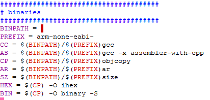

David SIORPAES
Posted on April 05, 2018 at 18:13
You need to specify the directory where your GCC toolchain is installed by setting the BINPATH variable in the Makefile.
Posted on April 05, 2018 at 18:42
I would expect this to be configurable in Cube, or even better, auto-detected.
Other toolchains (even free one's) do this.
